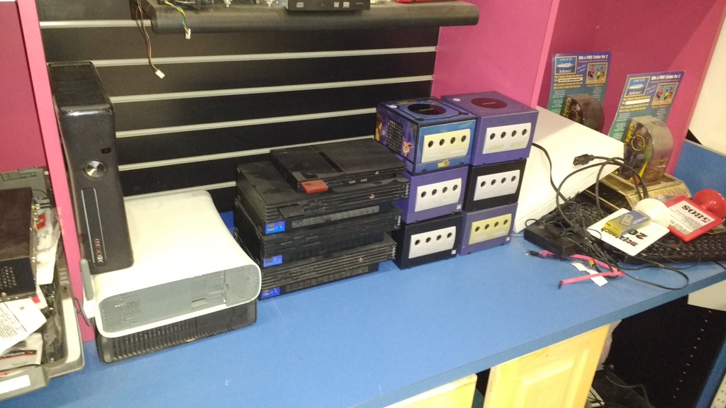

I went ahead and used my cap tester on the power supply
showed 2 bad caps
so I replaced them
now have 12 v again
I ended up cannibalizing the cube for some other parts so now I have a spare for the next batch I dig into
I spent all day yesterday installing region switches on 9 of the cubes lol
showed 2 bad caps
so I replaced them
now have 12 v again
