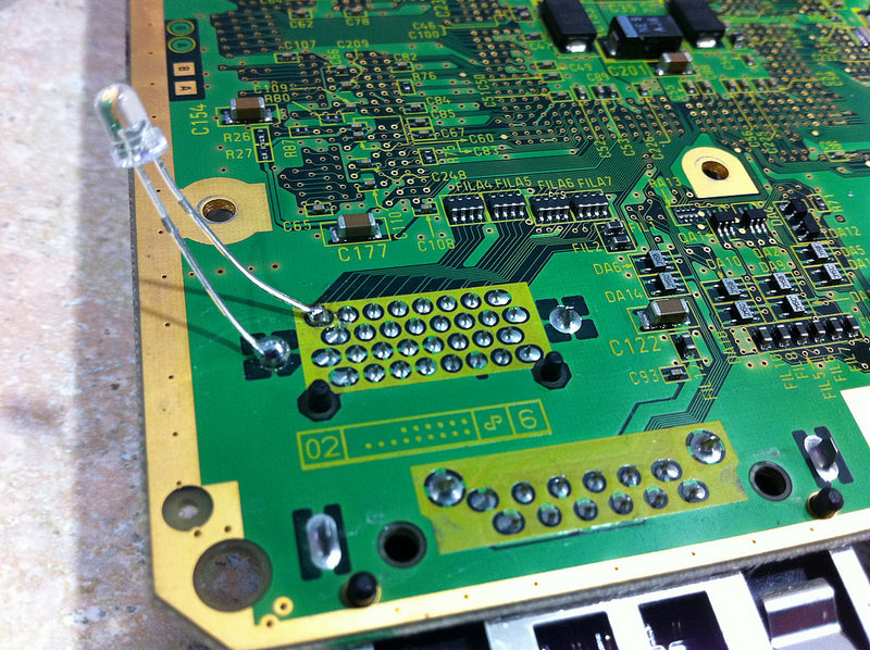

Re: Add DVD drive activity LED??
Postby megalomaniac » Sun May 31, 2015 5:25 pm
do you still need a schematic?
...this pic should show all you need...

megalomaniac wrote:do you still need a schematic?
LOL. No resistor? Might be a good idea depending on what color LED you use. Some have different voltage ratings.
Postby megalomaniac » Mon Jun 01, 2015 12:27 am
its only a 3v data signal
sure you can add a resistor, but why bother??

megalomaniac wrote:its only a 3v data signal
Good point I didn't know it was only 3 volts I was thinking 5 volts
