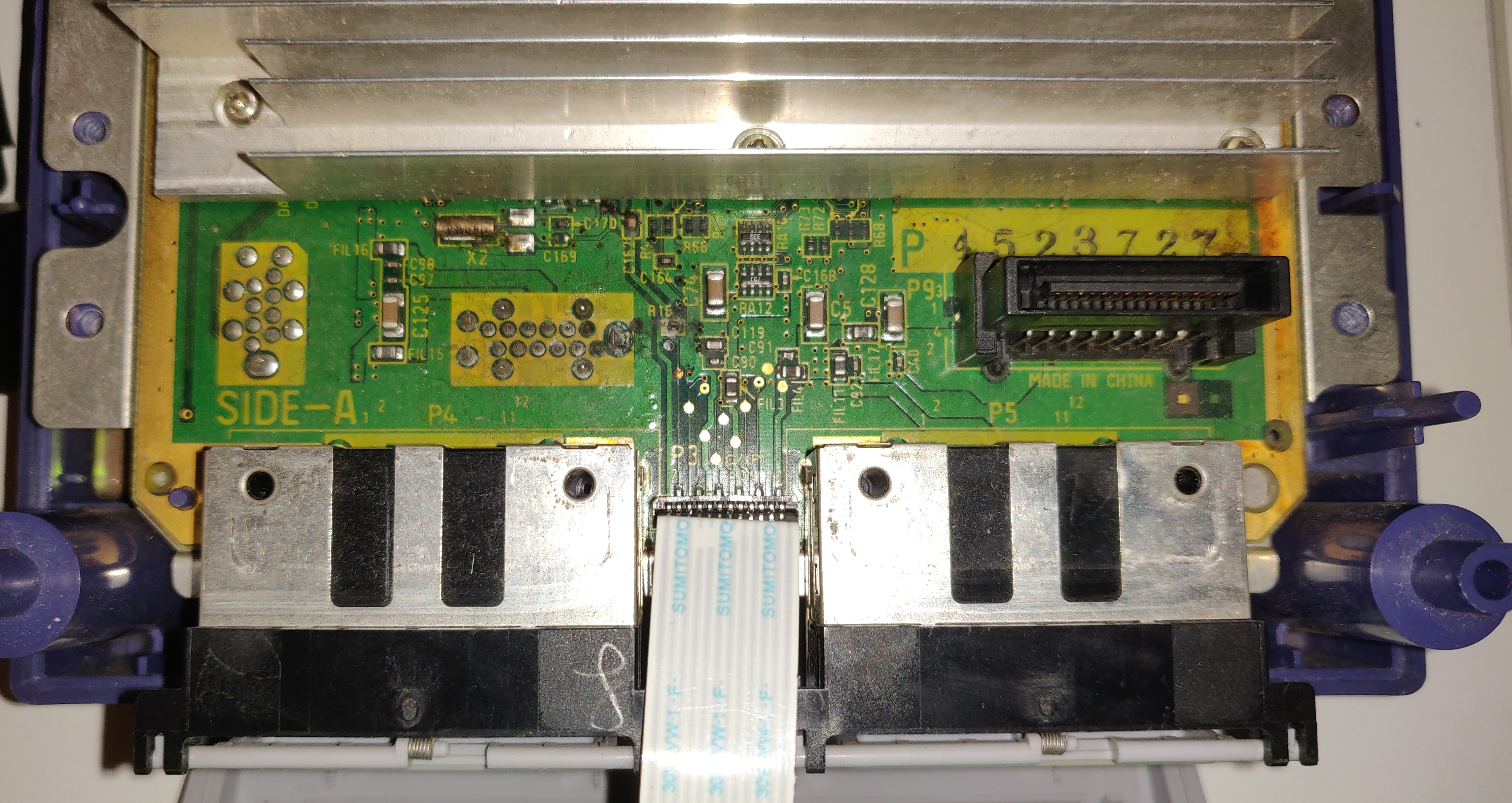

Seems to me like you should at least verify continuity to the controller port board via points on the GameCube mainboard. I've had a GameCube with corrosion on one of the legs of the flex connector.
Re: IPL settings (language and clock) are not getting saved. Battery already replaced
Now that you say it... There are some weird looking points at the mainboard. Looks like quite some corrosion and maybe even some resistors broken.
I don't think I can fix that, I'm still pretty bad with soldering.

the plate crystal appears to be corroded.
try to disconnect the flat, pass a smoothing pen, fold it, to see if the continuity ...

Clean the areas with isopropyl alcohol before trying to take measurements.
The battery is connected to Pin 1 of the front panel socket. Ensure you are getting battery voltage on the circle test point under R16 (might be R15?, it's left of C74).
R16 looks dodgy. It should have low resistance, a few hundred ohm at most. If it seems dodgy to you as well bridge it for now. If you cannot bridge the small R16 resistor points, run a jumper between the last pin of the IPL chip and Pin 1 of the socket.
Ensure C162 is not shorted, remove if it is.
X2 is the crystal oscillator for time keeping. It looks good, but make sure it's not bridge. Make sure C170 next to it is not shorted, remove it if it is.
Good luck.
