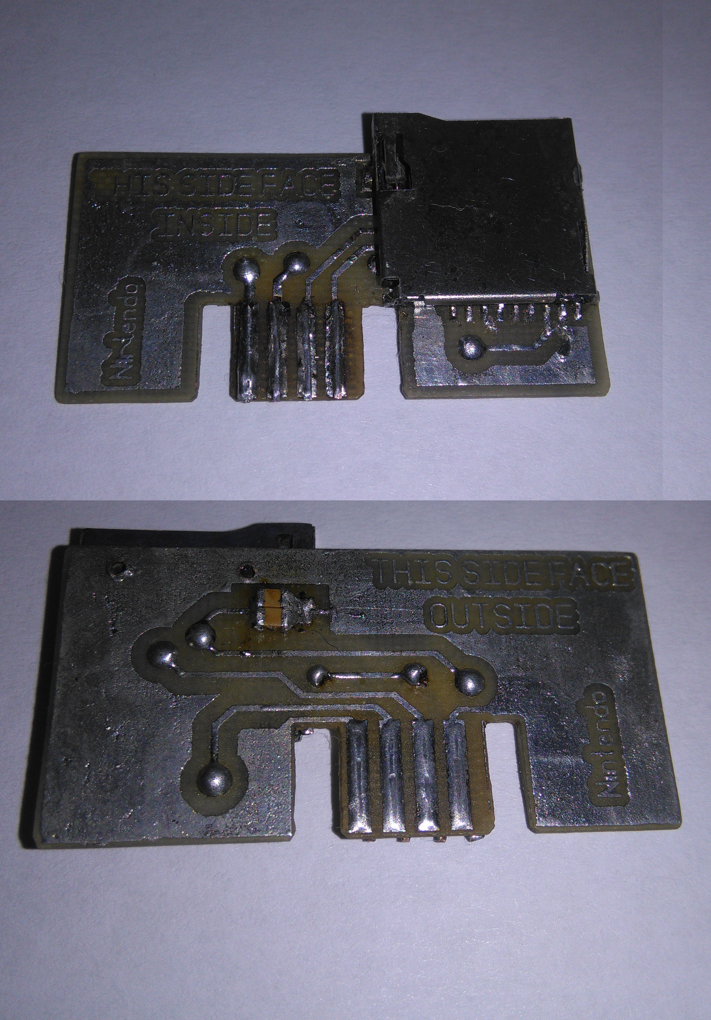

I am also having touble with a sp2sd homemade adaptor. Without finding a readymade one (at the time they were all sold-out), I asked my friend who is skilled with pcbs and soldering to botch one for me. So he made it, but he did not have a gamecube to test it for me. Also, he used spare parts from what he had, not exactly from the BOM provided.
Long story short, after several tweakings due to the board being too thin and veryfication that all contacts are intermittent, the adaptor can detect micro-sd cards, but only ones which are 2 Gb max, old ones. Neither of the newer cards I have, which can also be read through wiisd adaptor, are detected. I have a Transcend 16Gb MicroSDHC (class 6), A class 10 Samsung EVO MicroSDXC 32Gb, and an Apacer Class 10 32Gb microSDHC card.
Could it be a wrong capacitor? It is an smd ceramic one. My friend does not remember which capacity he put in it.
Using swiss-gc v0.4r775-1 which corrected detection of sp2sd. Also tried the latest version v0.5r813, chainbooting from wiisd, it has the same symptoms.

Here it is. The original capacitor was measured to be 4.5 uF, I replaced that with two 11 uF in parallel which gives 22 uF...
Still, I can read only 512 SD cards, the 2 Gb is detected (allows to select it at start) but won't read anything, included files.
The SD cards are formatted FAT32, primary partition, default cluster size.
(2.45 MiB) Not downloaded yet
Diego borella
Posts: 251
Location: Brazil
Re: Hi, about Serial port 2 USB for Swiss, any chance?
Post by Diego borella » Sat Apr 18, 2020 8:45 pm
Your SD2SP2 is a copy of SP2 citrus. :idea:
In that case, I think you should use an SMD, as it is closer to the original.
place a 22uf 10volts SMD.
a 22uf 16v electrolytic can be tried if nothing goes right, but take care of the polarity. :!:
but say, are the files in the folders seen and executed? did you do anything on the cards that were detected, copied something, deleted a file by swiss?
try to play an MP3 through Switzerland. a game on the 2gb card ... :arrow:
it looks like a capacitance problem. :geek: :!:
As I understand it, the closer to the SP2 plug, the lower the required voltage.
farther from the plug, more tension ... ;)
and the boot is from the drive: original DVD; or replacement of the unit?
or DVD recorded with Switzerland;
how do you get to swiss? :?:
ps. swiss is supporting exFAT now, you can try ... :arrow:
gckrz
Posts: 5
Joined: Mon Apr 13, 2020 8:04 pm
Post by gckrz » Sun Apr 19, 2020 3:01 pm
The Gamecube has XenoGC in it. I am booting from a DVD-R with swiss-gc v0.4r775-1.
I can execute the .dol from the 512 mb sd-card in the SP2SD. I did not put any iso-s on it, because they do not fit.
The 2 Gb card which is detected just shows up in the selection of sources. When I select it, it disappears from the selection, and then allows to select DVD or ram.
If I put another 2 Gb card or a 4gb card or a 16 Gb card or any of the 32 Gb cards after the boot sequence swiss just straight lists the content of the DVD.
I tried electrolytic capacitors 22uF 25V and 100 uF 16V - same symptoms.
The same cards do detect and list filesystem if inserted in wiisd (so should not be a file system problem).
rafer_22
Posts: 9
Joined: Sat Sep 26, 2015 2:31 am
Post by rafer_22 » Sun Apr 19, 2020 5:11 pm
Forget the capacitor, you don't need it. Check your traces and pin assignment on sd slot. If everything looks alright, make another

100uf !? never change the UF capacitor, just voltage! :o
there is something strange and still unknown in SD2SP2.
for me, it didn't work without a capacitor.
for Papy.G, it worked ...
see my cube is USA_ntsc
Papy.G PAL EUR
does this have to do? :?:
and more,
do not use the 775-1, it is a double-edged sword. :evil:
you will need to reset your SRAM. (remove the battery, the control slot part).
burn DVD use the 688, :arrow:
if there is no need for the capacitor, why did Dan put it there? :?: :ugeek:
for my part: keep the standard capacitor, reset your SRAM and try Swiss r688.
... :arrow:

@Diego borella If you check the mainboard, you can see a capacitor near to serial Port 2 connector and many around. So, you don't need external capacitor. Dan knows a lot, but he's not the only one 😉
Posts: 973
Post by Papy.G » Mon Apr 20, 2020 9:37 am
In electronic components integration, one should always pair one chip to its decoupling cap, the closer the better, it is a basic rule.
In real life, there are many cases where it is not absolutely needed, so the cap pads are left unpopulated on many PCBs.
This is the case with most SDGeckos (WiiSD, WiiKey), and they work flawlessly without it.
Citrus just wanted to do things as the state of the art suggests to do, and did well.
If the SD2SP2 doesn't work without a cap, the wires or contact may be the problem, if it doesn't work with a cap, skip it.
Just do not use outdated SWISS releases, always keep up to date so you'll get the better from it. :roll:
Hey, It's not as if SWISS was a big company OS with slowness on updates and bugfixes and not really caring about user feedback, we're talking about one of the most reactive team with direct comunication from creators to users! 8-)
So for this same reason, don't burn discs uselessly, and save your drive's laser at the same time (not touching to that Pot anymore!)
For DOL-101 models, never solder right at the back of the CPU, the risk is to desolder its pads while soldering to the vias on the opposite of the MB.
Pin assignment is quite straightforward:
SP-SD
VCC-VCC
GND-GND
CS-CS
CLK-CLK
MOSI-MOSI
MISO-MISO
Beware, if MISO and MOSI are labelled DI/DO, you'll have to cross the wires so that it will be:
DO-DI
DI-DO
That's what I previously related, the mis-labelling in some pictures we took as reference leaded many to mis-match those wires.
