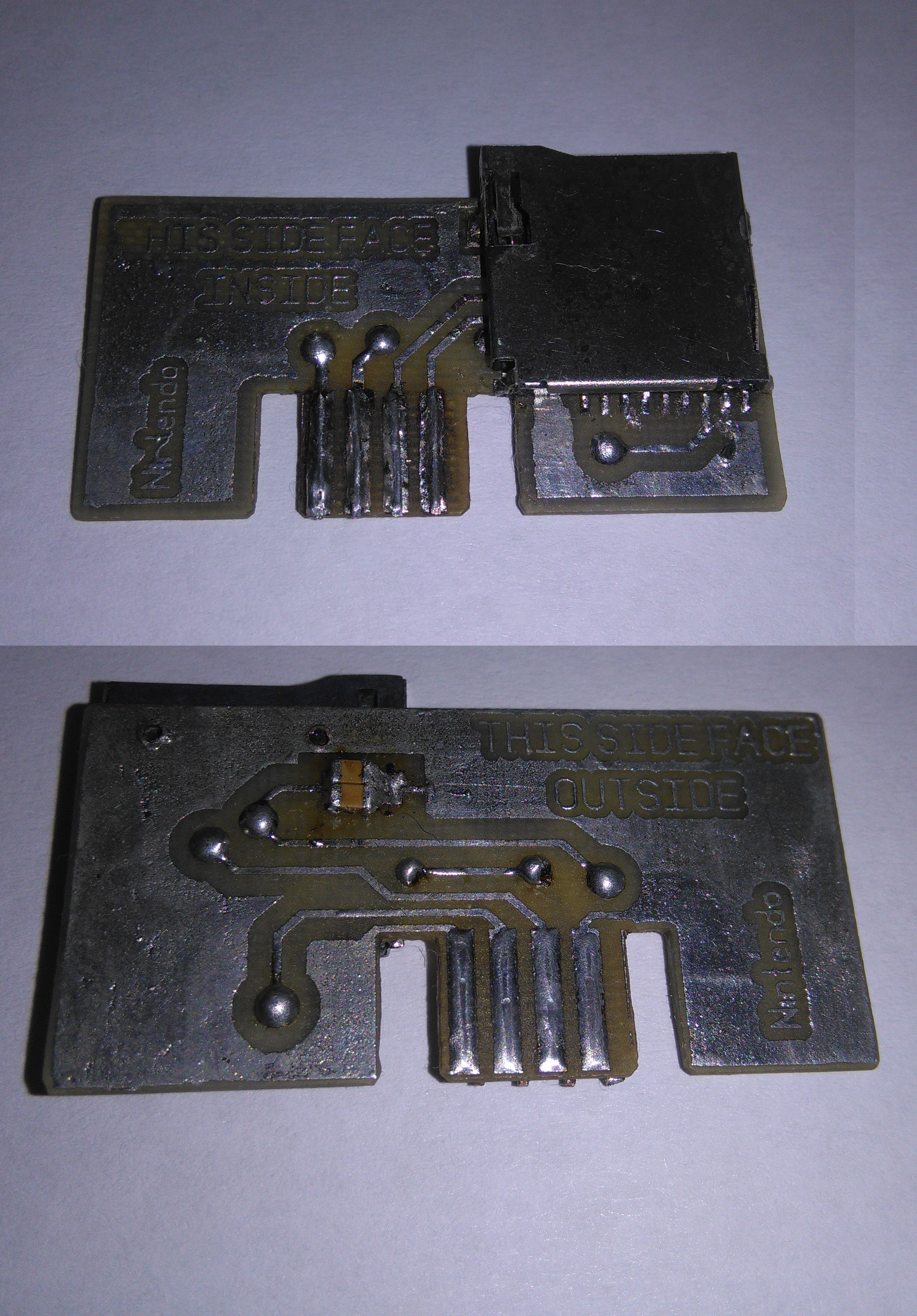

I am also having touble with a sp2sd homemade adaptor. Without finding a readymade one (at the time they were all sold-out), I asked my friend who is skilled with pcbs and soldering to botch one for me. So he made it, but he did not have a gamecube to test it for me. Also, he used spare parts from what he had, not exactly from the BOM provided.
Long story short, after several tweakings due to the board being too thin and veryfication that all contacts are intermittent, the adaptor can detect micro-sd cards, but only ones which are 2 Gb max, old ones. Neither of the newer cards I have, which can also be read through wiisd adaptor, are detected. I have a Transcend 16Gb MicroSDHC (class 6), A class 10 Samsung EVO MicroSDXC 32Gb, and an Apacer Class 10 32Gb microSDHC card.
Could it be a wrong capacitor? It is an smd ceramic one. My friend does not remember which capacity he put in it.
Using swiss-gc v0.4r775-1 which corrected detection of sp2sd. Also tried the latest version v0.5r813, chainbooting from wiisd, it has the same symptoms.
Thank you first of all for everybody involved, who made SP2SD possible, software and hardware wise.
- Diego borella
- Posts: 249
- Location: Brazil
Re: Hi, about Serial port 2 USB for Swiss, any chance?
samsumg SD evo doesn't seem to work.
formatted the fat32 SDs?
use electrolytic capacitor for homemade SP2SD2. SMD does not.
how do you get to swiss?
send the adapter photo ...
or soldier on the board?
do not use together with wiisd.
additional information and what you are looking for are in the same post ...![Arrow :arrow:](./images/smilies/icon_arrow.gif)
![Confused :?](./images/smilies/icon_e_confused.gif)
![Exclamation :!:](./images/smilies/icon_exclaim.gif)

Here it is. The original capacitor was measured to be 4.5 uF, I replaced that with two 11 uF in parallel which gives 22 uF...
Still, I can read only 512 SD cards, the 2 Gb is detected (allows to select it at start) but won't read anything, included files.
The SD cards are formatted FAT32, primary partition, default cluster size.

Your SD2SP2 is a copy of SP2 citrus.
In that case, I think you should use an SMD, as it is closer to the original.
place a 22uf 10volts SMD.
a 22uf 16v electrolytic can be tried if nothing goes right, but take care of the polarity.
but say, are the files in the folders seen and executed? did you do anything on the cards that were detected, copied something, deleted a file by swiss?
try to play an MP3 through Switzerland. a game on the 2gb card ...
it looks like a capacitance problem.
As I understand it, the closer to the SP2 plug, the lower the required voltage.
farther from the plug, more tension ...
The Gamecube has XenoGC in it. I am booting from a DVD-R with swiss-gc v0.4r775-1.
I can execute the .dol from the 512 mb sd-card in the SP2SD. I did not put any iso-s on it, because they do not fit.
The 2 Gb card which is detected just shows up in the selection of sources. When I select it, it disappears from the selection, and then allows to select DVD or ram.
If I put another 2 Gb card or a 4gb card or a 16 Gb card or any of the 32 Gb cards after the boot sequence swiss just straight lists the content of the DVD.
I tried electrolytic capacitors 22uF 25V and 100 uF 16V - same symptoms.
The same cards do detect and list filesystem if inserted in wiisd (so should not be a file system problem).
Forget the capacitor, you don't need it. Check your traces and pin assignment on sd slot. If everything looks alright, make another
@Diego borella If you check the mainboard, you can see a capacitor near to serial Port 2 connector and many around. So, you don't need external capacitor. Dan knows a lot, but he's not the only one ![😉](//twemoji.maxcdn.com/2/svg/1f609.svg)
In electronic components integration, one should always pair one chip to its decoupling cap, the closer the better, it is a basic rule.
In real life, there are many cases where it is not absolutely needed, so the cap pads are left unpopulated on many PCBs.
This is the case with most SDGeckos (WiiSD, WiiKey), and they work flawlessly without it.
Citrus just wanted to do things as the state of the art suggests to do, and did well.
If the SD2SP2 doesn't work without a cap, the wires or contact may be the problem, if it doesn't work with a cap, skip it.

Pin assignment is quite straightforward:
SP-SD
VCC-VCC
GND-GND
CS-CS
CLK-CLK
MOSI-MOSI
MISO-MISO
Beware, if MISO and MOSI are labelled DI/DO, you'll have to cross the wires so that it will be:
DO-DI
DI-DO
That's what I previously related, the mis-labelling in some pictures we took as reference leaded many to mis-match those wires.
