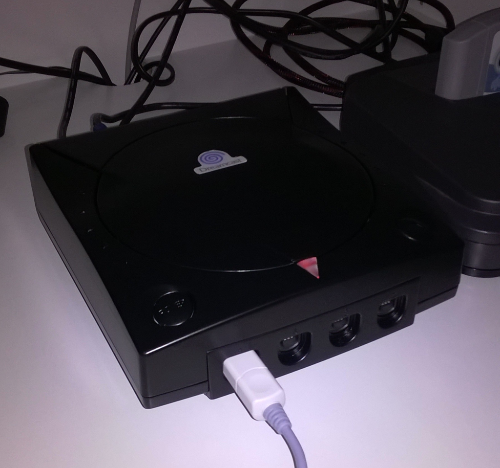

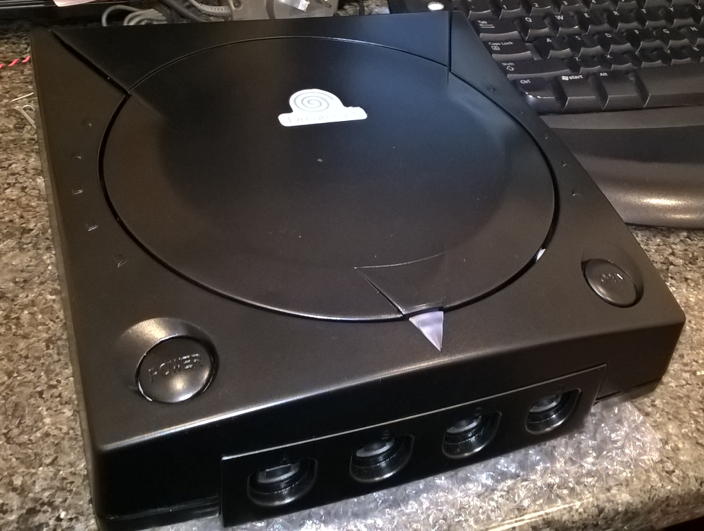

These are the only photos of it that I have with me on my phone so the quality isn't the greatest.
In between the first and final coat when I had to sand down some imperfections and spots where the paint ran. I thought about leaving it like this since it looked pretty interesting :P If I'd painted it properly the first time this wouldn't have happened but I didn't really know what I was doing at the time.
Spoiler
Show
Just after I'd painted it the second time and put the logo back on, and the back too. It has a nice matte look and feel like the original to it.
Spoiler
Show
After about 6 months of use photo, it's holding up very well. I would've rather left the power/eject buttons original colour but they were very badly damaged and needed sanding so I repainted them. They looked like someone had used a screwdriver to lift them up rather than just pushing them down.
