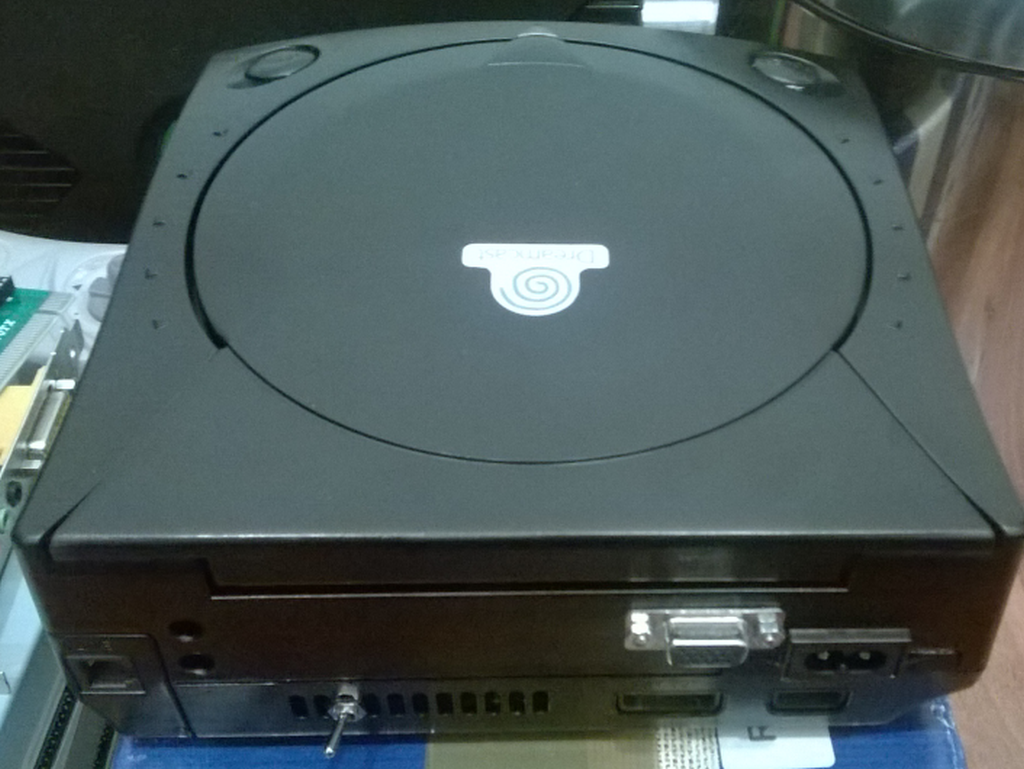

Eventually I ended up settling for a PAL Dreamcast that had succumbed to yellowing plastic and some heavy scratching, but it did work. It needed a bit of work to clean it up.
Here's a list of mods I've performed on it:
* PAL Dreamcast
* Replace SRAM battery with slot based battery/holder
* Install internal VGA + Port on the back
* Dual BIOS via piggybacked flashrom to switch between debug (region free) and normal
* Replace internal power supply with 160W Pico PSU
* Replace GDRom drive with GDEmu SD
* Sand and spray paint the console in black vinyl dye

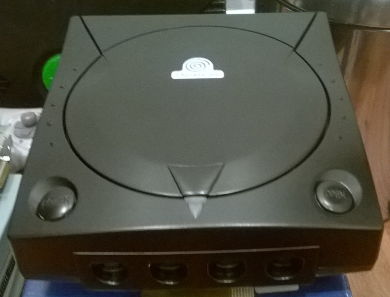

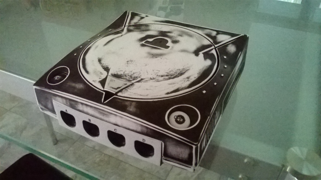

This was my first ever plastic/console painting, I'd probably want to paint it again by using filler and sanding it to remove some deep scratches but who cares, it's good enough and there's no paint runs.badsector wrote: My consoles plastic is also yellowed, maybe I should try to repaint it, but I never done it. Are there any painting tutorials that you can recommend?

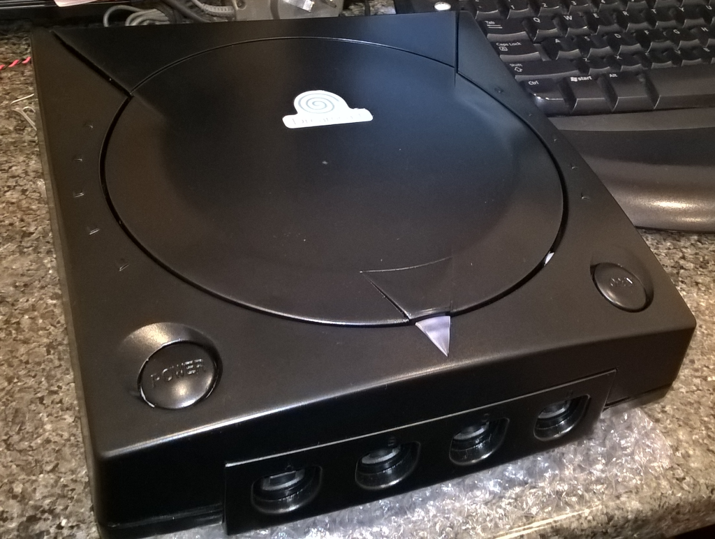

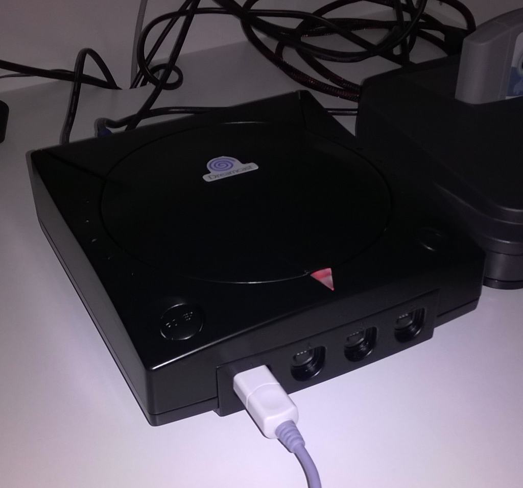

These are the only photos of it that I have with me on my phone so the quality isn't the greatest.
In between the first and final coat when I had to sand down some imperfections and spots where the paint ran. I thought about leaving it like this since it looked pretty interesting
If I'd painted it properly the first time this wouldn't have happened but I didn't really know what I was doing at the time.
Just after I'd painted it the second time and put the logo back on, and the back too. It has a nice matte look and feel like the original to it.
After about 6 months of use photo, it's holding up very well. I would've rather left the power/eject buttons original colour but they were very badly damaged and needed sanding so I repainted them. They looked like someone had used a screwdriver to lift them up rather than just pushing them down.
Opened up while I was re-doing my internal VGA mod wiring (very dodgy) and setting the picoPSU in a proper secure spot.
In action

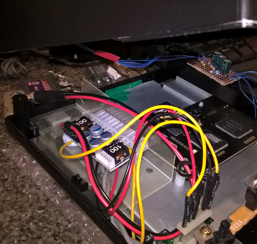

Me again.
Encouraged by emu_kidid, i've finally completed my PicoPSU setup.
I didn't know which PSU i'd have to buy for this PicoPSU, so i finally decided to use a GameCube PSU
I had a dead Cube around so i gathered the PSU socket. I used some balsa wood sticks with double sided tape. The exact height for this is 2.00 cm, a common size in balsa wood furniture, lucky :]
Pics better than comments :
I'm rather satisfied with it

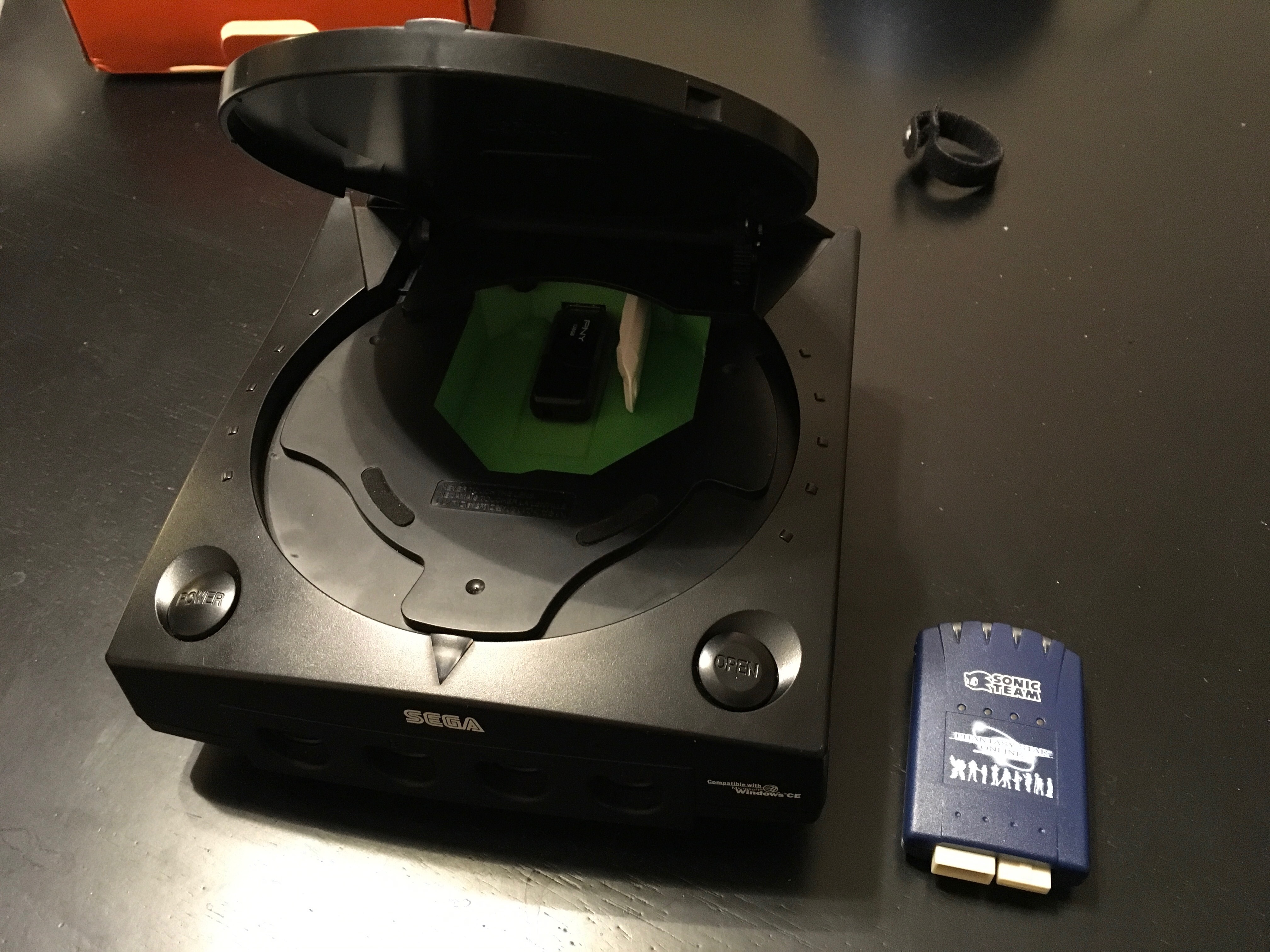

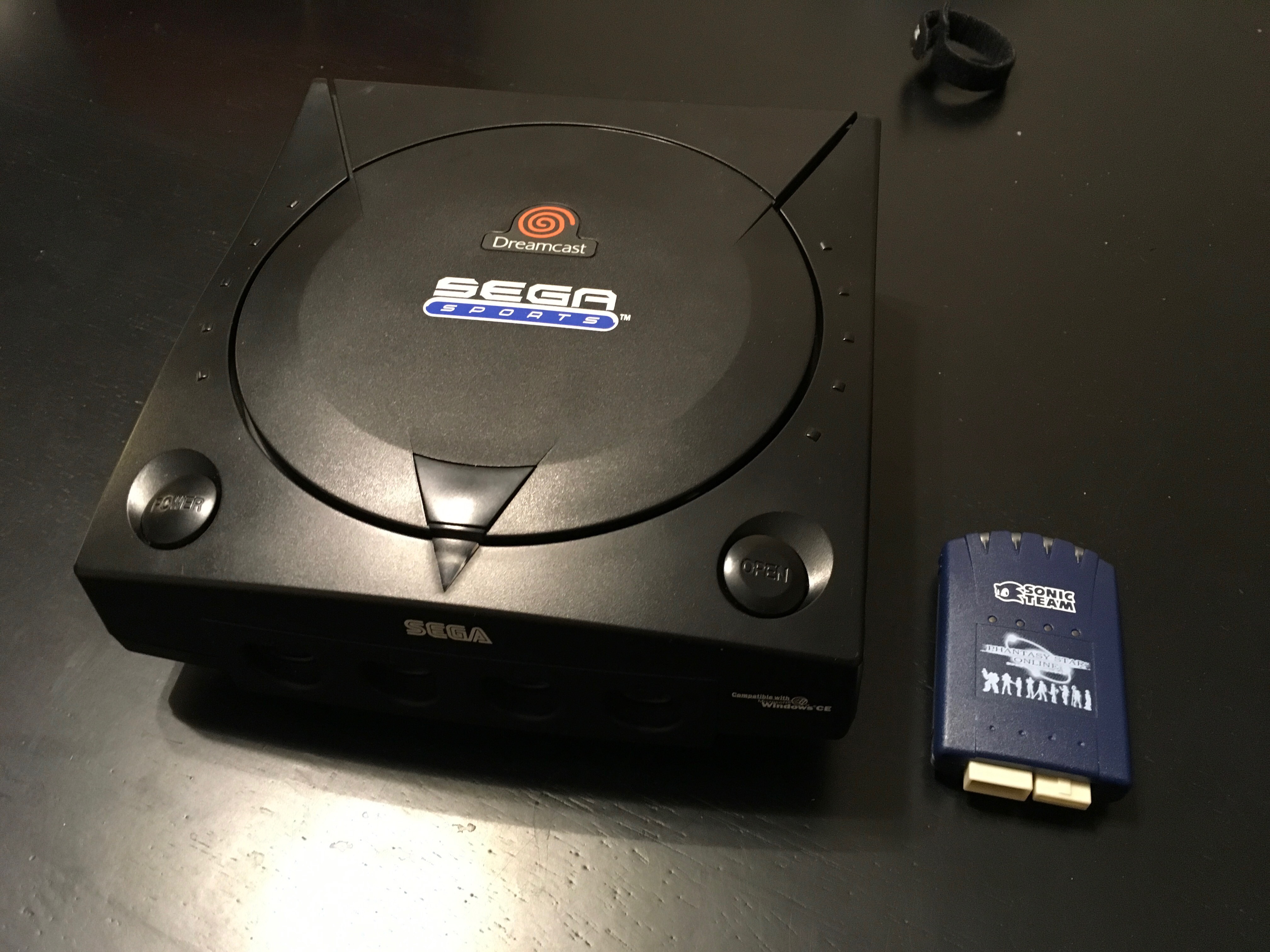

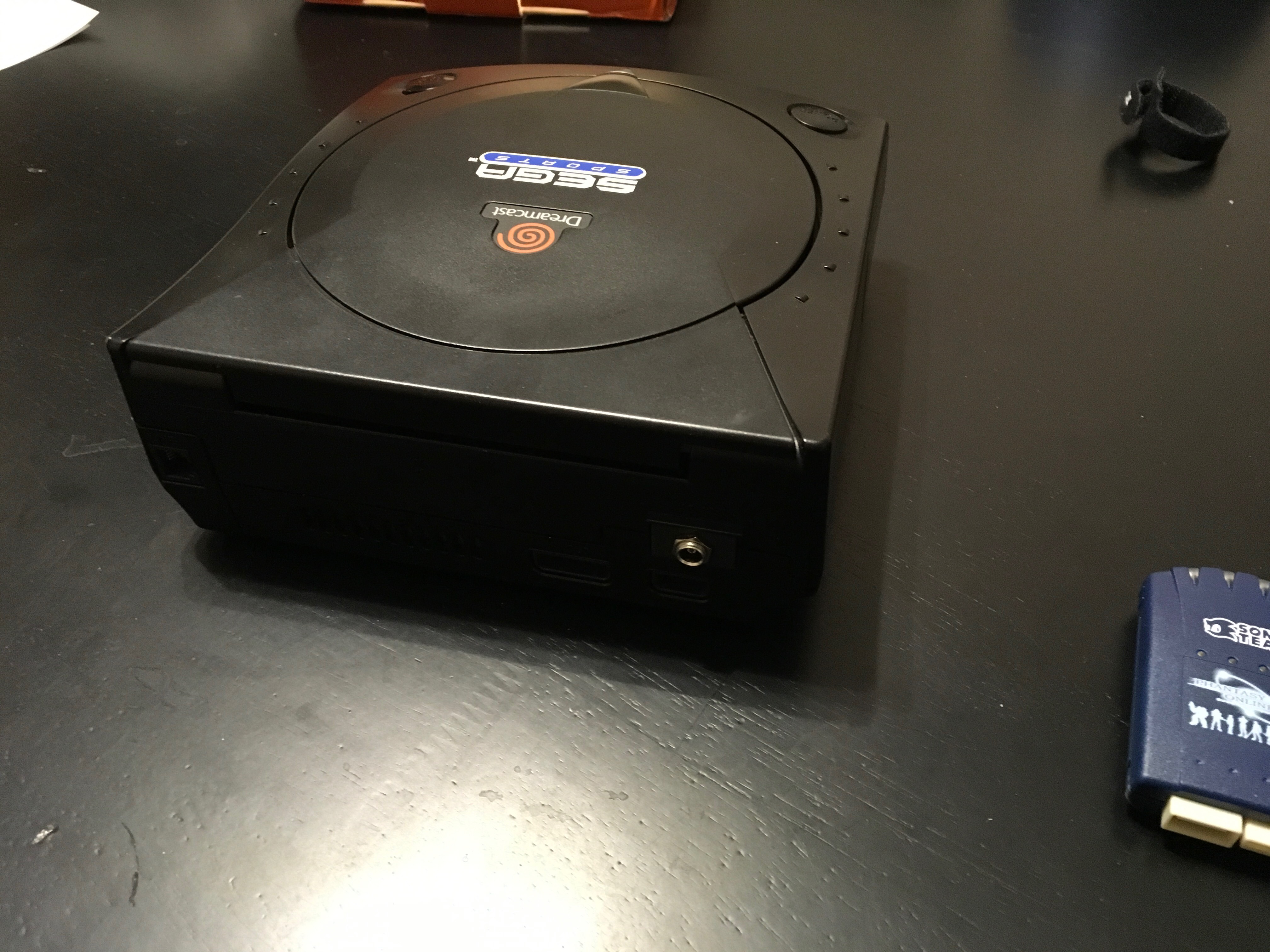

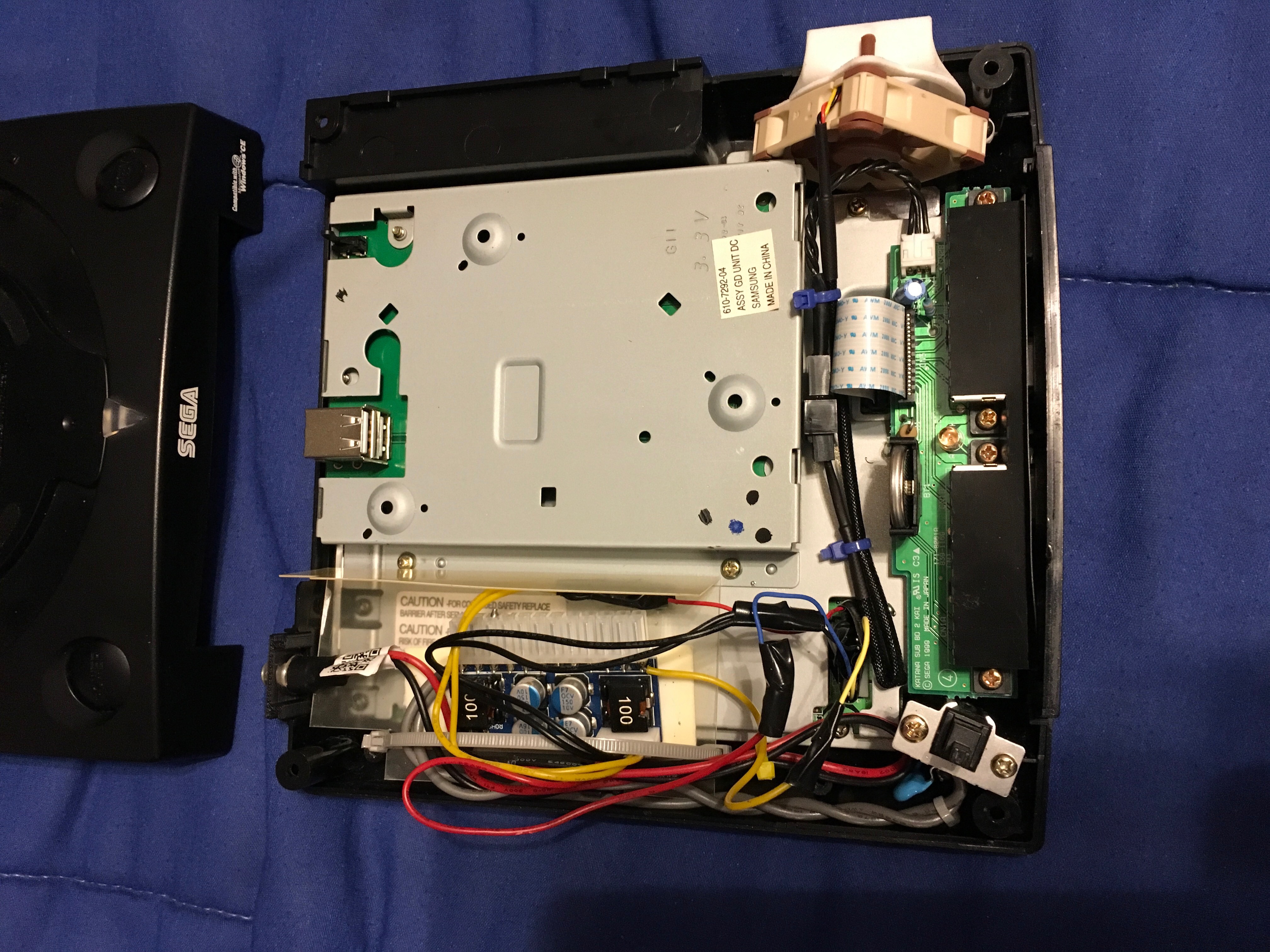

I love this thread! It is cool to see that I'm not alone in soldering the PicoPSU to the pins vs. using a connector. Emu_kidd's black one is sick! So is MockyLock's white one! I go back and forth on white vs. black Dreamcasts. I think the black hides imperfections better through. It is crazy that you used a Gamecube power connector! The rectifier must send the right specs for the PicoPSU.
My last project was a Dreamcast! The thing that I love about the Dreamcast is how it was ahead of it's time and had the superior versions of games for a couple year window. I ultimately made my own version of a Dreamcast Arcade machine. Which cost a ton but when compared to a NBA Showtime/NFL Blitz Sportstation arcade machine it really wasn't so bad. I mainly did this for Showtime, Blitz, and NBA Hoopz but there are so many other awesome arcade games on Dreamcast aswell. Plus my setup can be used with many other systems aswell including the Gamecube!
My Dreamcast:
Sega Sports Edition Black in nearly mint shape "There is one hairline scratch I discovered after owning it for a week"
Pico PSU
40 mm quieter fan with 3d printed mounts
slot loading system battery
USB GDrom with 3d printed insert
5 brand new controllers
3 band new VMU's
3 used rumble packs
Behar Bros Akura, Toro, Hanzo
Awesome PSO 4 in 1 memory card
I have a spare white revision 1 Dreamcast just encase anything happens with the motherboard. I did all the modding myself on the Dreamcast and it was frustrating at times for several stupid reasons such as wiring the new fan wrong, buying a 12v fan instead of a 5v.

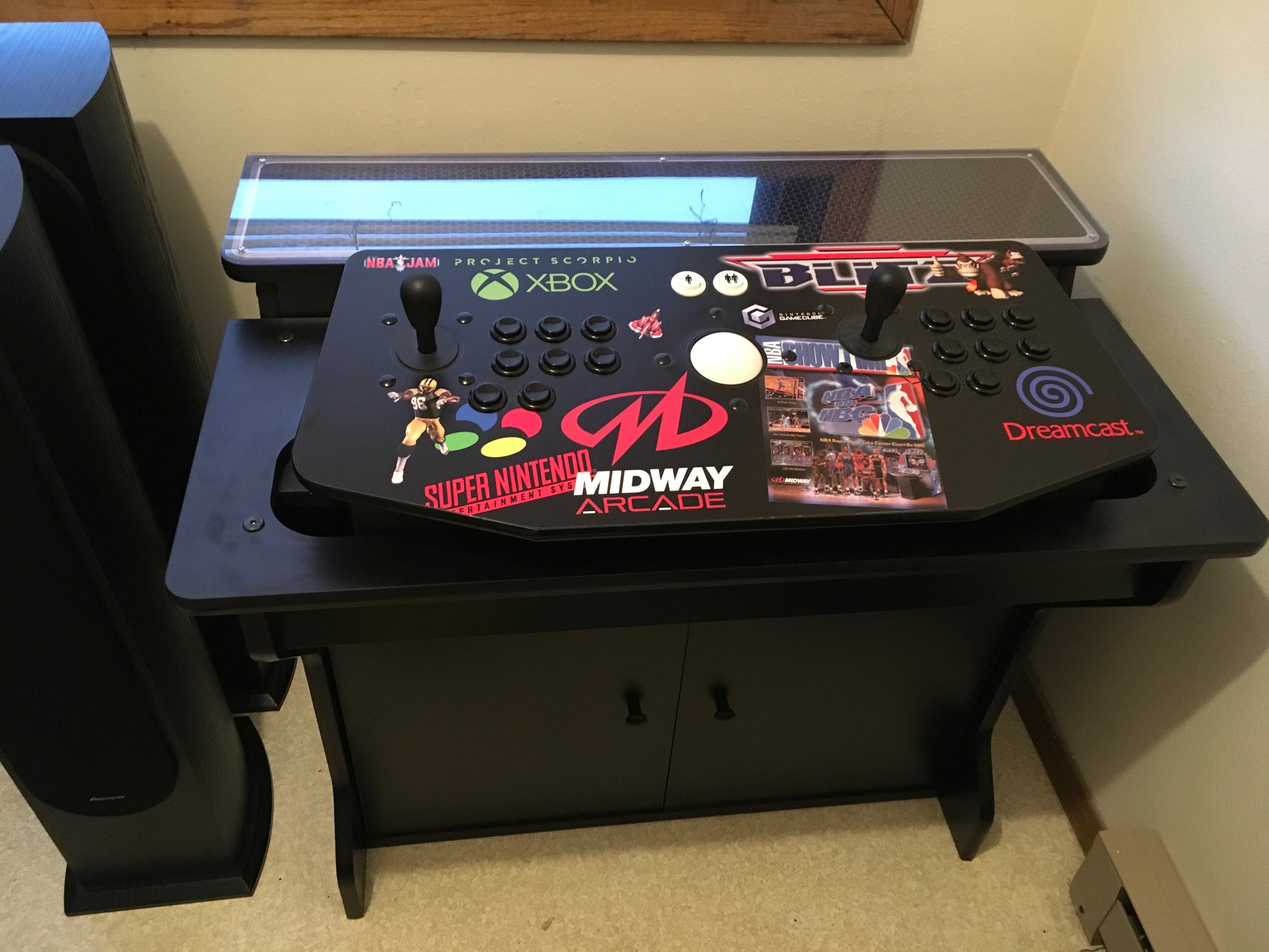

My arcade setup:
Recroommasters pedestal arcade cabinet
X-arcade tankstick with all the system adapters and the 4 way switching box to switch between systems
Custom overlay for the tankstick that I designed
two belkin conserve power strips so I can leave the Dreamcast power button pressed in and turn it on from the side of the cab, the second strip is to be used with TV's that auto power on when plugged in such as my tv
Another cool thing about this setup is that it costs a ton for a 4 player arcade setup so in the rare occasions that I want to play 4 player with this I can have player 3 and 4 use controllers. Normally I have controller three always plugged in with a VMU. Plus this setup can accommodate any modern TV and when not gaming you can just watch TV on it.

I also have a Dreamcast keyboard for Typing of the Dead! Here is a pic of the inside of my console.
Re: Dreamcast owners - post your setup
Very cool Dreamcast! Yeah, it's still great to play and the VGA output is super crisp.
