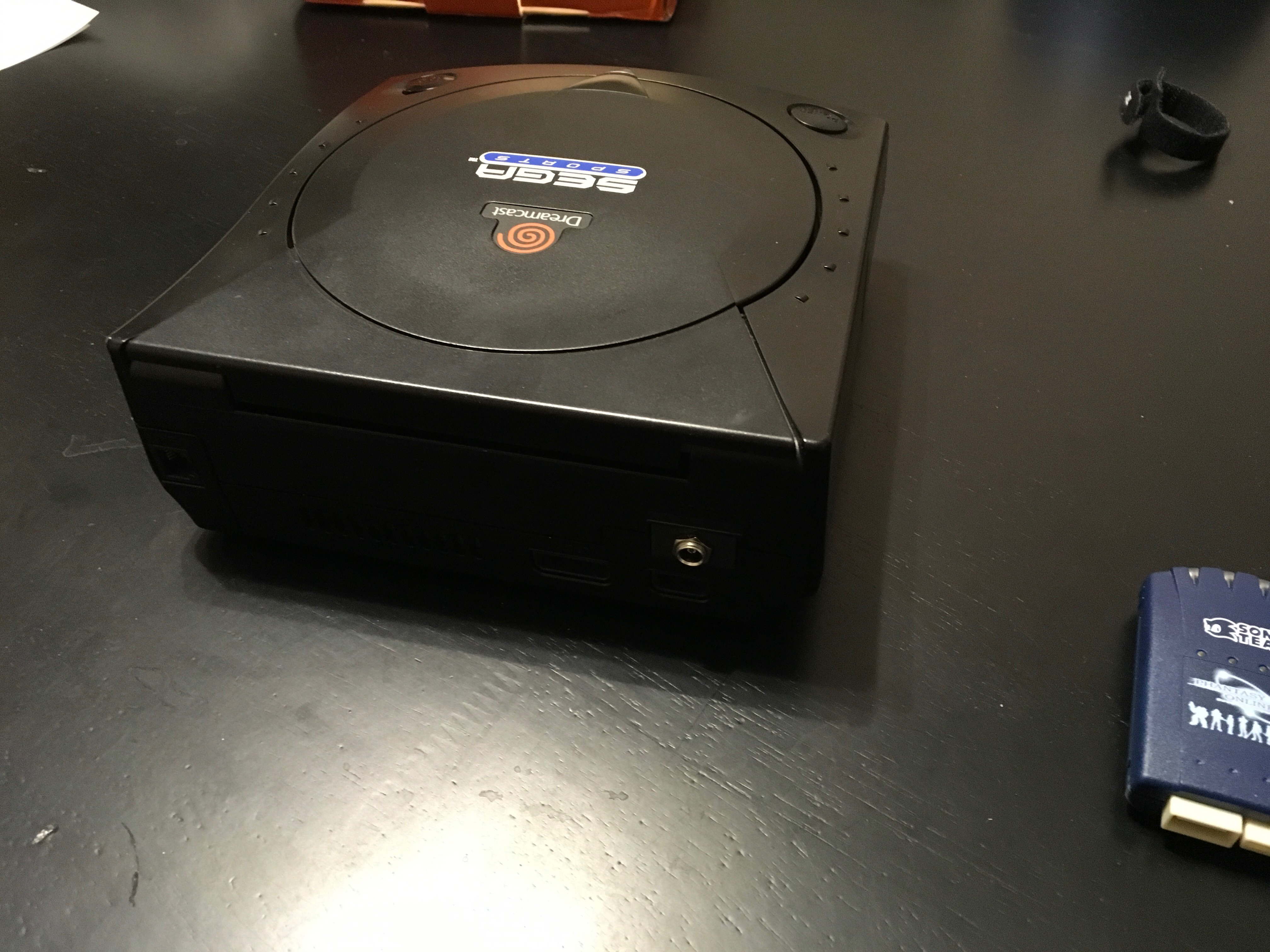

dreamcastopen
(2 MiB) Not downloaded yet

I also have a Dreamcast keyboard for Typing of the Dead! Here is a pic of the inside of my console.
dreamcastinsides
(2.18 MiB) Not downloaded yet
